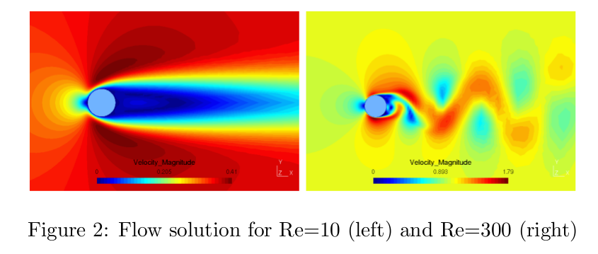

发表于 2014-2-4 00:51:39 | 显示全部楼层
Unsteady runs for Re=10 and Re=300

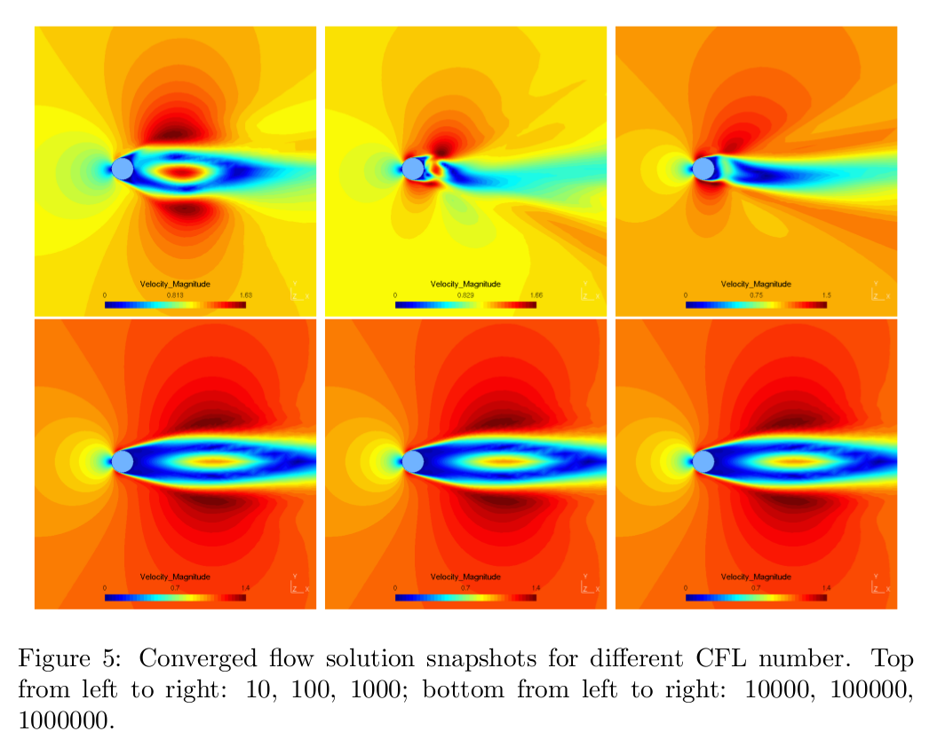

发表于 2014-2-4 00:52:36 | 显示全部楼层
Now, run steady simulation for Re=300 with different CFL numbers.
