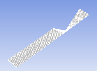

用fluent16.0导入网格之后出现下列信息,也没有没有找到/solve/initialize/repair-wall-distance的命令,求各位大侠指点
The mesh contains high aspect ratio quadrilateral,hexahedral, or polyhedral cells.
The default algorithm used to compute the wall distance required by the turbulence models might produce wrong results in these cells.
Please inspect the wall distance by displaying the contours of the 'Cell Wall Distance' at the boundaries.
If you observe any irregularities we recommend the use of an alternative algorithm to correct the wall distance.
Please select /solve/initialize/repair-wall-distance using the text user interface to switch to the alternative algorithm.

发表于 2015-8-3 21:20:43 | 显示全部楼层
网格的长宽比太大了
发表于 2015-8-5 09:26:06 | 显示全部楼层
纵横比大,但是在边界层附近纵横比达到1000以上还是可以接受的

发表于 2015-8-28 08:15:03 来自手机 | 显示全部楼层
这个只是提醒不是错误,上面的说的对,边界层里面长宽比都非常大

发表于 2015-8-29 17:33:39 | 显示全部楼层
在命令行输入  /solve/initialize/repair-wall-distance

发表于 2015-9-6 19:10:18 | 显示全部楼层
考虑好网格点分布,其实长宽比一般不建议超过5,边界层内另说,因为一般边界层内高度方向都会加密。
从离散方程求解的角度说只要在梯度变化不大的地方长宽比大一点也不会有太大影响。
