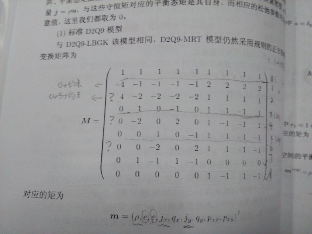

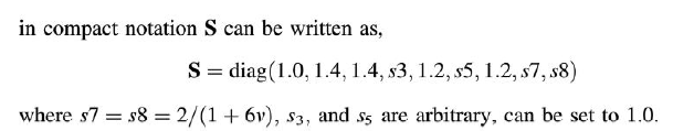

求教前辈们问题:请问标准D2Q9多松弛模型中的转化矩阵M是如何导出的?郭老师教材中说根据正交矩阵,现在推不出第3,5,7行系数向量,另外针对对角矩阵S的取值和另外一本书中不大一样?关于Sq和Sv,Skesai如何取值,谢谢!
其他教材S取值
其他教材S取值
郭老师教材S取值
郭老师教材S取值

you may want to read the following paper to understand how the matrix M and the relaxation rates are derived:
P. Lallemand and L.-S. Luo.
Theory of the lattice Boltzmann method: Dispersion, dissipation, isotropy, Galilean invariance, and stability.
Physical Review E 61:6546-6562 (June 2000).
