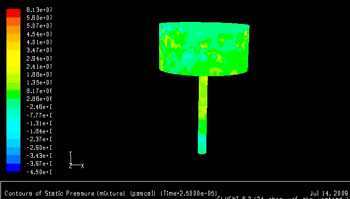

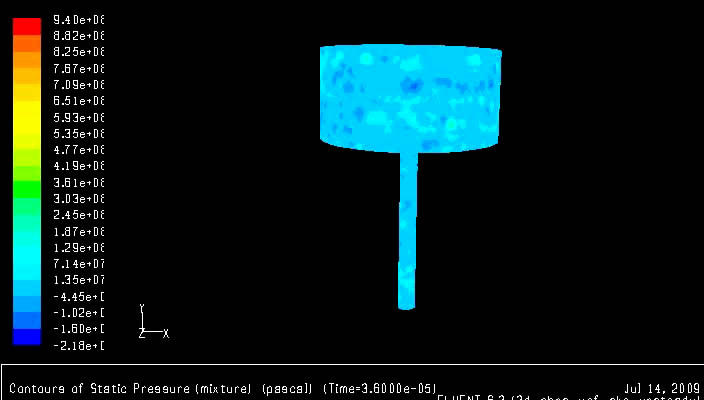

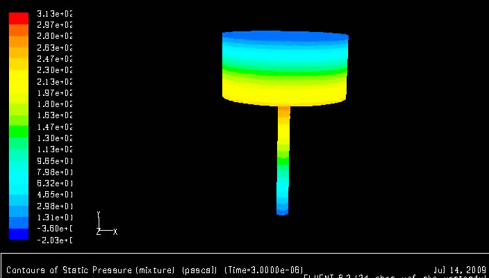

请教一下这是怎么回事,谢谢
Error: Global courant number is greater than 250.0. The
velocity field is probably diverging. Please check the solution
and reduce the time-step if necessary.

时间步长太多,库郎数超过限制条件,计算不稳定,建议减小时间步长!
