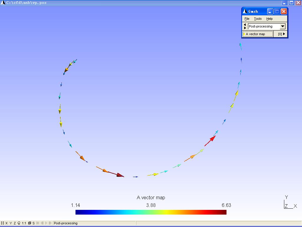

大家好!我想请问大家一个问题:
我有这样一组数据:
X1=[-0.02 -0.022 -0.025 -0.029 -0.032 -0.033 -0.033 -0.033 -0.031 -0.027 -0.021 -0.014 -0.005 0.004 0.014 0.024 0.035 0.045 0.055 0.064 0.073 0.08 0.087 0.094 0.099 0.103 0.106 0.108 0.109 0.109];
Y1=[0.019 0.018 0.015 0.01 0.001 -0.007 -0.016 -0.026 -0.036 -0.045 -0.053 -0.06 -0.065 -0.069 -0.072 -0.073 -0.072 -0.07 -0.066 -0.061 -0.056 -0.049 -0.041 -0.032 -0.023 -0.014 -0.004 0.006 0.016 0.026];
Z1=[0.074 0.064 0.054 0.046 0.041 0.036 0.032 0.028 0.025 0.021 0.019 0.017 0.015 0.014 0.014 0.013 0.012 0.012 0.012 0.011 0.011 0.011 0.011 0.011 0.011 0.01 0.01 0.01 0.01 0.01];
U1=[-1.37824 -2.22638 -2.44356 -0.81676 -0.30375 -0.44474 -0.29404 0.316167 0.667712 1.46056 3.57287 1.21934 4.75574 6.31168 1.12811 1.89939 4.46643 3.21406 3.37154 4.56943 3.27366 4.28151 1.81179 1.28676 1.89325 1.63809 0.695445 0.275342 -0.15252 -0.59254];
V1=[-1.54736 -2.20774 -3.22207 -1.795 -1.72684 -2.69333 -3.90843 -4.09634 -2.01719 -2.42673 -3.75292 -0.89043 -2.34265 -1.96993 -0.17833 -0.00714 0.668934 0.953378 1.46339 2.68167 2.44825 4.05106 2.16214 2.04701 3.81166 4.32965 2.71251 2.45966 2.11925 3.08292];
W1=[-2.08806 -2.71439 -3.05562 -1.45233 -1.38153 -1.97994 -2.36645 -1.89669 -0.77317 -0.77004 -1.03296 -0.2176 -0.49022 -0.42416 -0.06194 -0.08383 -0.17412 -0.11023 -0.10089 -0.15124 -0.11069 -0.17704 -0.08525 -0.0723 -0.11209 -0.11924 -0.04913 0.02571 0.114309 0.189065];
PTOT1=[-119.373 -118.867 -119.71 -117.677 -121.636 -121.94 -117.805 -110.691 -97.559 -90.0395 -92.9689 -65.8672 -78.4749 -78.7269 -31.6704 -27.0665 -38.0697 -19.6307 -13.7667 -20.05 2.38359 -8.57581 32.6148 48.3011 36.5919 41.3651 72.5589 85.5554 98.0057 92.1205];
其中,X1,Y1,Z1分别是点的坐标分量,U1,V1,W1分别是速度分量,PTOT1是点上的压力值,如何导入tecplot中进行后处理呢?
发表于 2010-5-12 22:07:56 | 显示全部楼层
按后处理软件要求的格式重组你的数据.
写段小程序最方便.例子多的是.
这是我处理后,用免费的gmsh画的,
