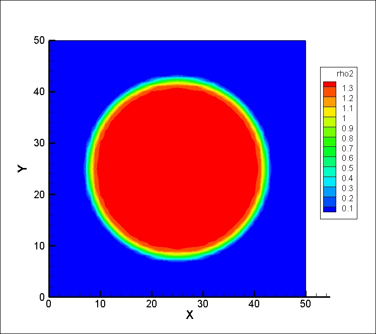

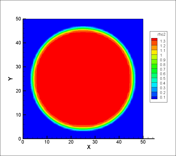

先前用S-C模型模拟液滴的形变来验证Laplace定律,现象正确了,但是出现一些问题,请教下大家。
附件的两张图,初始化-----相同直径,第一张图密度内1.0,外1.5,第二张图内1.5,外1.0
到最后内外密度两个图差不多了,基本都是内1.3,外1.2,但是第一个图直径变小,第二个图变大了
也就是在该模型下流体是可压缩的,请教下,是我写的程序有问题(是的话我自己再去学学,再麻烦指点下注意哪里),还是这个模型本身是就这样?

The model is compressible in the sense that it allows density variation. The reason for the drop to shrink/expend, I suspect, is that stable densities are determined by Maxwell construction numerically. Thus, they differ from the theoretical values.

Dear Luo,
        is this a incompressble model with an artificial compression effect ?
sincerely,
ZK
发表于 2014-8-31 11:10:10 | 显示全部楼层
回复 3# benliubuzhi 的帖子
Yes, you are correct.
