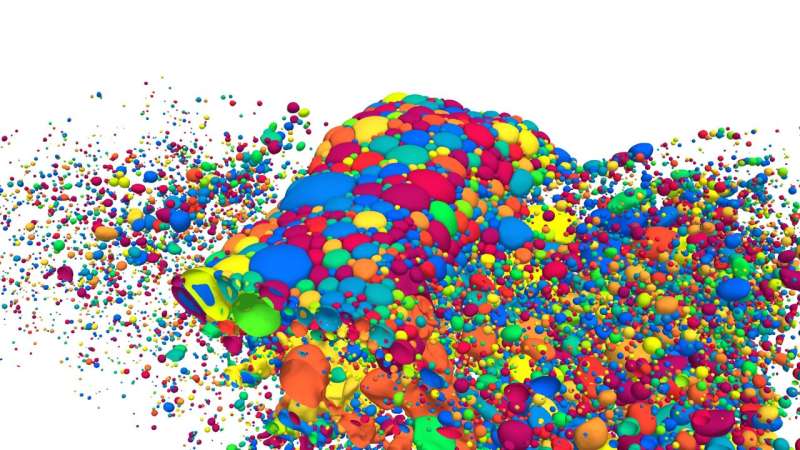

Instead of color-coating each individual bubble, the researchers broke the foam down into a grid, with each cell of the grid containing at most a part of four bubbles. Each bubble inside the cell is color-coated, either yellow, green, blue or red.
A simulation of a foaming waterfall showing bubbles under the surface. Credit: CSE-Lab/Harvard SEAS
"If I have four partial bubbles inside a cell, then the remaining piece of the bubbles have to be in the neighboring cells," said Petr Karnakov, a graduate student at SEAS and first author of the paper. "We developed an algorithm that can go into other cells and find the remaining pieces of the bubble, matching green to green, blue to blue, etc. So, instead of needing millions of colors, you just need four."

这篇文章主要提到泡沫流计算的一种新方法,从拉格朗日型的跟踪方法,转为一种对网格内部4个气泡的标记法,结果使得计算效率大大提高,可计算的泡沫数量也大大提高,对于工程应用类的计算应该有参考价值。
