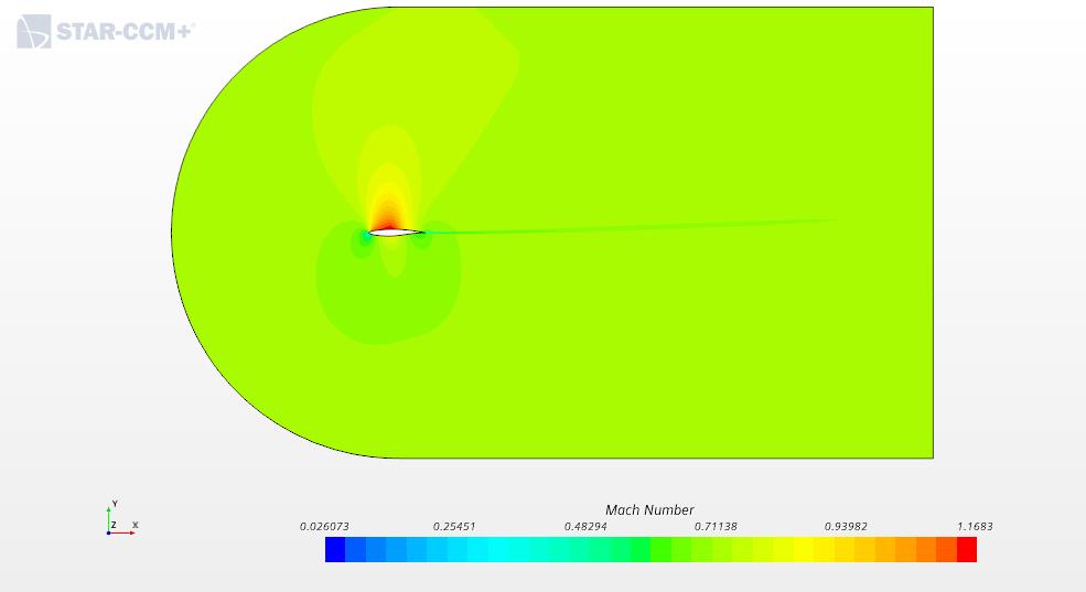

M0.725,a=2.92,动力粘度4.58e-5,理想气体,SA模型,计算300步,
Starccm+
A=2.92,Cx=0.022695478257907693,Cy=0.6991038310313866
Fluent
A=2.92,Cx=0.02146994,Cy=0.6894628
差量Dcx=5.7%, DCy=1.4%
