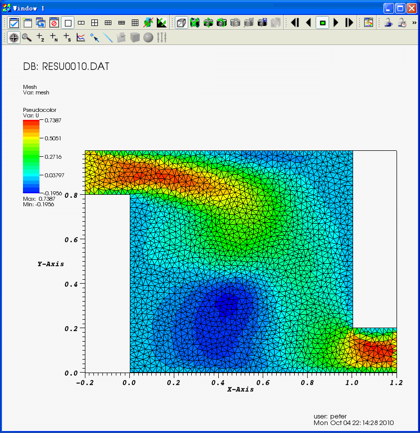

 楼主| 发表于 2010-10-4 19:18:31 | 显示全部楼层
终于能用VisIt2.1加载了。
非结构网格,cellcentered数据,头是这样的:
  TITLE = "Delaunay 2D Grid"
  VARIABLES =  "X" "Y" "U" "V"
  ZONE T="ZONE 1: FE-Feild"   N=1699 E=3196 DATAPACKING=BLOCK ZONETYPE=FETRIANGLE  VARLOCATION=(NODAL,NODAL,CELLCENTERED,CELLCENTERED)  DT=(SINGLE SINGLE SINGLE SINGLE )
    0.000000E+00
