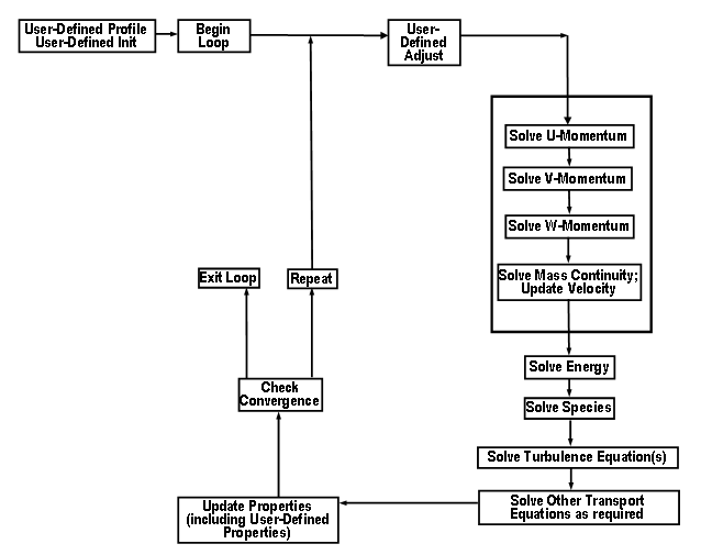

按照help逻辑图画的,DEFINE_PROFILE(name,t,i)与DEFINE_INIT一样只是在迭代前调用,而并不参与迭代计算(见下图)。可诸如第二三类边界条件,有诸如内部变量C_T(c,t)参与的边界表达式,在每一次迭代前难道边界条件不更新么,这个矛盾我不太理解。往牛人们指教。

实在不好意思,自己找到了help里的一句话:
Note that PROFILE and SOURCE UDFs are called by each "Solve" routine for the variable currently under consideration (e.g., species, velocity).
看来不是有图就一定有真相
